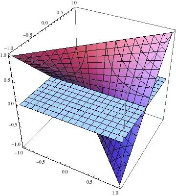

The question seems to be about gaining geometric intuition for flat morphisms of (affine) schemes. Let $A = \mathbb{C}[x, y, z]/(x z - y)$, $X = \operatorname{Spec} A$ and $\mathbb{A}^2_\mathbb{C} = \operatorname{Spec} \mathbb{C}[x, y]$. The claim is that the projection $\pi : X \to \mathbb{A}^2_\mathbb{C}$ is not a flat morphism of schemes. Let's look at a picture.
         plot
$X$ is quite evidently twisted. More formally, if one looks at the dimensions of the fibres over the points of $\mathbb{A}^2_\mathbb{C}$, one sees that at $(0, 0)$ there is a 1-dimensional fibre, but everywhere else the fibre is 0-dimensional. It is a fact that a finitely generated module over a noetherian domain is locally free if and only if the dimensions of the fibres over maximal ideals is constant, so this confirms our intuition that $X$ is not flat over $\mathbb{A}^2_\mathbb{C}$
Of course, we could take a more direct approach. From the above discussion we know that there should be a problem at $(0, 0)$, so let $\mathfrak{m} = (x, y) \subset \mathbb{C}[x, y]$. We have a short exact sequence $$0 \to \mathfrak{m} \to \mathbb{C}[x, y] \to \mathbb{C} \to 0$$ and upon tensoring with $A$, we get a right exact sequence $$A \otimes \mathfrak{m} \to A \to \mathbb{C}[z] \to 0$$ I claim that the first map is not injective. Indeed, in $A$, $$z \cdot x = 1 \cdot y$$ but in $A \otimes \mathfrak{m}$ $$z \otimes x \ne 1 \otimes y$$ since there are no $f \in \mathbb{C}[x, y]$, $g \in A$, and $h \in \mathfrak{m}$ such that $$\begin{align*} g f & = z & h & = x \\ g & = 1 & f h & = y \end{align*}$$ Hence $A$ is not flat over $\mathbb{C}[x, y]$.

    Dear Zhen, I don't understand your argument that $z \otimes x \ne 1 \otimes y$. What criterion are you using to show that two elementary tensors of the form $u \otimes v$ and $u' \otimes v'$ are not equal? Please explain that in the abstract context of two $R$-modules $U,V$ over a ring $R$. – Georges Elencwajg Feb 18 '12 at 12:29
  • @Georges: I'm assuming that the linearity relations for $\otimes$ do not play a role here – this is somewhat unjustified, I agree. Perhaps the fact that the modules in question are all $\mathbb{C}$-vector spaces justifies my assumption. The relations I am thinking of are the ones of the form $g f \otimes h = g \otimes f h$. – Zhen Lin Feb 18 '12 at 13:11
  • @ZhenLin This may seem like an elementary question but can you explain how you plotted $\operatorname{Spec}(A)$? –  Feb 19 '12 at 03:47
  • @BenjaminLim: You're thinking far too high-tech. I plotted the equation $x z - y$. – Zhen Lin Feb 19 '12 at 10:11
  • @ZhenLin I thought you plotted $\operatorname{Spec}(A)$ because your next line was "$X$ is quite evidently twisted" :D. Wait you plotted the equation $w = xz - y$? –  Feb 19 '12 at 11:10
  • I meant $x z - y = 0$. It's a simple contour plot. – Zhen Lin Feb 19 '12 at 12:46
