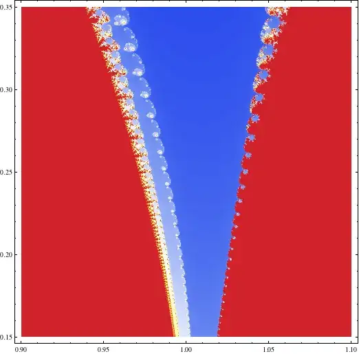

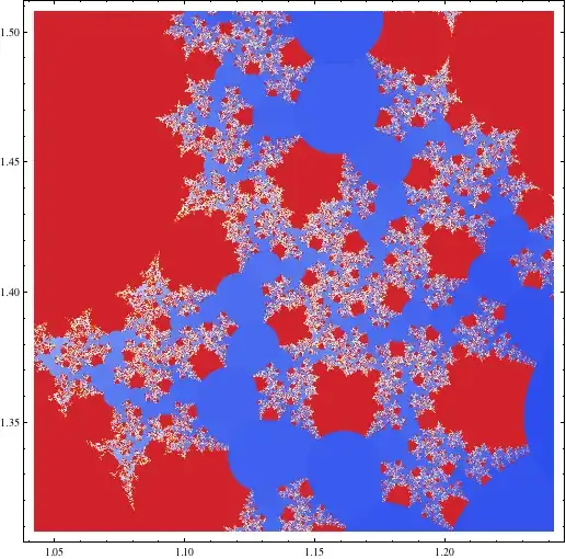

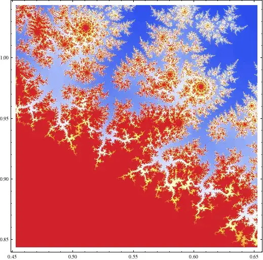

I have no idea about well-studied, but here's what I've gotten from a bit of playing around (here's the relevant Mathematica code).
$\boldsymbol{f_c(z)=\cos(z)+c}$ where $\cos(z)$ is defined however Mathematica defines it, using the escape time algorithm with escape radius $10\pi$ and 100 iterations maximum:
$\boldsymbol{f_c(z)=\sin(z)+c}$ appears to be the same as cosine, but horizontally translated.

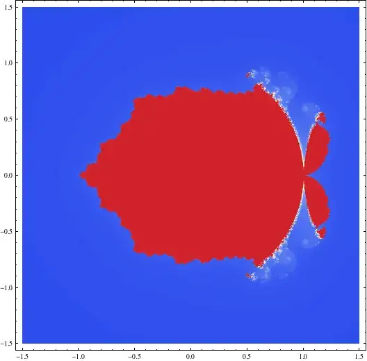

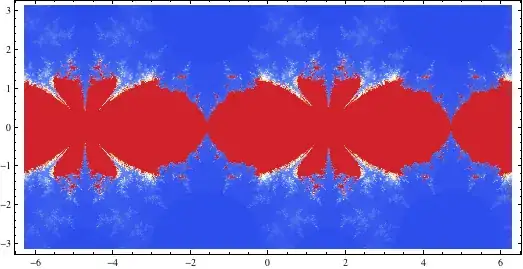

$\boldsymbol{f_c(z)=e^z+c}$, using the escape time algorithm with escape radius 50 and 100 iterations maximum (it's vertically periodic with period $2\pi$):

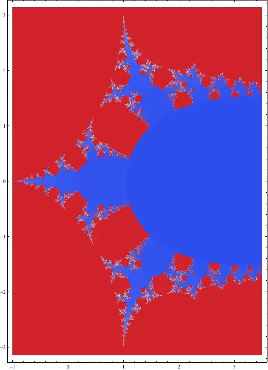

edit (Mathematica code edited, too): $\boldsymbol{f_c(z)=cz(1-z)}$ (since camccann's answer mentions logistic maps) using the escape time algorithm with escape radius 50 and 200 iterations maximum:

2The discontinuous boundaries where the blue meets the red without going through the white and yellow are quite surprising. Are you sure they're not an artifact of your escape time algorithm? Certainly for $\sin$ and $\cos$, you can't assume that if $|z|$ is large, the iterations will diverge... – Sep 29 '10 at 22:44
@Rahul: Well, $\sin$ and $\cos$ get large if $\Im z$ is large... – J. M. ain't a mathematician Sep 30 '10 at 12:27
1@J.M.: Yes, but that doesn't guarantee divergence either. If, say, $z = \pi+1000i$, then $\cos(z) = -\cosh(1000)$ is very large, but $\cos(\cos(z))$ is within $|z| \le 1$ (and further iterations will stay there). – Sep 30 '10 at 17:16

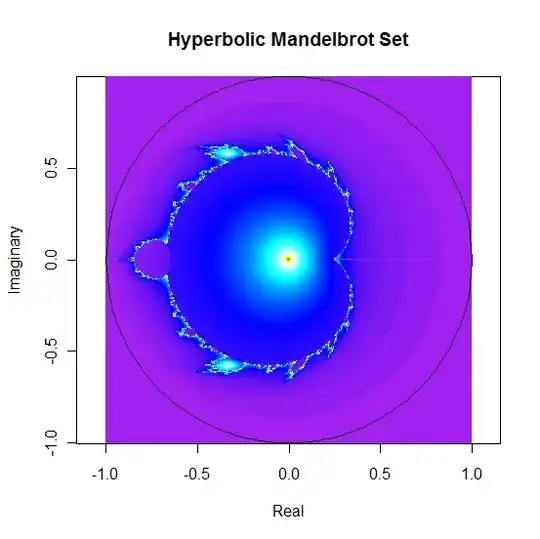

Here's the Mandelbrot set on the Poincaré Disk. I made it by replacing all the usual operations in the iteration
$$z_{n+1} = z_n^2+c$$
by "hyperbolic" equivalents. Adding a constant was interpreted as translating in the plane, and the hyperbolic equivalent is then
$$z \mapsto \frac{z+c}{\bar{c}z+1}$$
For the squaring operation, that meant I used angle doubling plus rescaling of the distance by a factor two based on the distance formula for the Poincaré Disk:
$$d(z_1,z_2)=\tanh^{-1}\left|\frac{z_1-z_2}{1-z_1\bar{z_2}}\right|$$
- 16,108
+1. I'm not sure how surprised I should be that (at least superficially) it doesn't look all that different. – Isaac May 01 '11 at 20:48
I guess not. I just made it while I was toying around with hyperbolic geometry since another question prompted me to. It's just like the original but deformed. – Raskolnikov May 01 '11 at 20:50
Regardless of how similar or different it looks to the original, it's still a really cool thing to have tried. – Isaac May 01 '11 at 20:53
