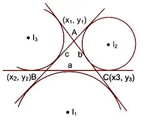

I am just wondering that how the coordinate of the excentre comes out if we know the coordinates of vertices of the triangle.
Dylan
  • 16,575
Pratyush
  • 2,586
Let $A=(x_1, y_1)$, $B=(x_2, y_2)$ and $C=(x_3, y_3)$ are the vertices of a triangle $ABC,$ $c,$ $a$ and $b$ are the lengths of the sides $AB,$ $BC$ and $AC$ respectively. Then coordinates of center of ex-circle opposite to vertex $A$ are given as
$$I_1(x, y) =\left(\frac{–ax_1+bx_2+cx_3}{–a+b+c},\frac{–ay_1+by_2+cy_3}{–a+b+c}\right).$$
Similarly coordinates of centers of $I_2(x, y)$ and $I_3(x, y)$ are
$$I_2(x, y) =\left(\frac{ax_1-bx_2+cx_3}{a-b+c},\frac{ay_1-by_2+cy_3}{a-b+c}\right),$$
$$I_3(x, y) =\left(\frac{ax_1+bx_2-cx_3}{a+b-c},\frac{ay_1+by_2-cy_3}{a+b-c}\right).$$
Source

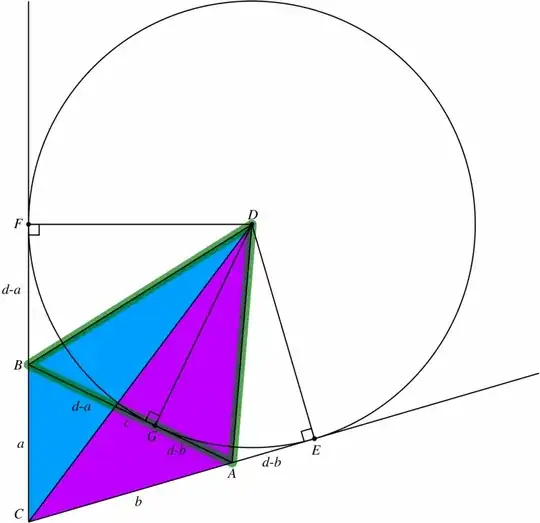

Consider the following diagram:
excircle center computation
Using Barycentric Coordinates, we get that the coordinates of $D$ to be $$ D=\frac{|\triangle BCD|A+|\triangle ACD|B-|\triangle ABD|C}{|\triangle BCD|+|\triangle ACD|-|\triangle ABD|}\tag{1} $$ The weight from $\triangle ABD$ is negative since that triangle is outside of $\triangle ABC$.
Since each of the triangles in $(1)$ has the same altitude, which is the radius of the excircle, their areas are proportional to the lengths of their bases, which are the sides of $\triangle ABC$. This gives $$ D=\frac{aA+bB-cC}{a+b-c}\tag{2} $$
