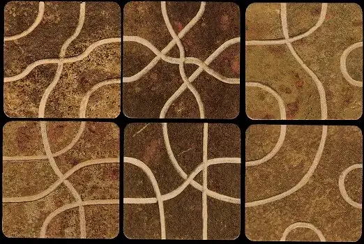

The boardgame Tsuro consists of tiles, which each have 8 entry points. Each tile connects each point to exactly one other point. The game manual claims every tile is unique. The game consists of 35 such tiles.
A Tsuro tile
How many unique such tiles could possibly exist?

    Well, here's why you can't just divide by $4$: Not all the rotations are unique - consider the tile in which each point is connected to the one directly opposite it on the other side - then this tile is rotationally symmetric. Another example in which not all rotations are unique is the bottom left tile in the picture you provided. – Peter Woolfitt Jan 02 '15 at 10:31
