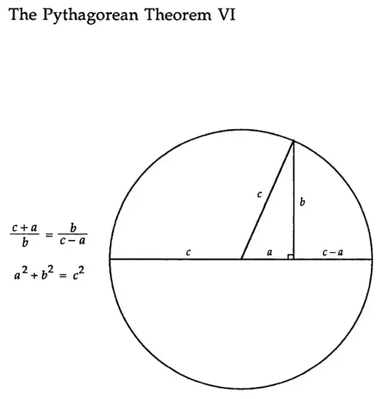

Your punishment for awarding me a "Nice Question" badge for my last question is that I'm going to post another one from Proofs without Words.
How does the attached figure prove the Pythagorean theorem? enter image description here
P.S. No, I will not go through the entire book page-by-page asking for help. P.P.S. No, I am not a shill for the book. Just a curious math student.

I think the diagram ought to include lines that connect all the three points on the large circle into a triangle. It is then (I think) supposed to be known that an inscribed triangle that has a diameter as one of its sides is right, and that an altitude towards the hypotenuse divides a right triangle into two similar triangle. The proportion $\frac{c+a}{b}=\frac{b}{c-a}$ then comes from these two similar triangles. Cross multiplying with the denominators produces $c^2-a^2=b^2$.

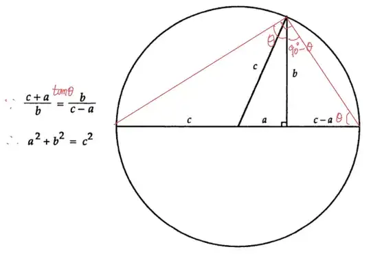

I think the picture is missing two more lines: those connecting all the points on the circle. Once these segments are drawn, we see two important right-angled triangles: one has sides $c+a$, $b$ and the hypotenuse; the other has sides $c-a$ and $b$ and the hypotenuse. A quick counting of angles shows that these two triangles are similar, hence we obtain the ratio written on the left: $$ \frac{c+a}{b} = \frac{b}{c-a}. $$ And the theorem follows from this ratio by 'cross multiplying'.

  • When you said "all the points on the circle", I didn't know what you meant. I thought you meant every point that's on the circle, not all the points where the drawn lines intersect the circle. D'oh! :D. I have to think about how we know those two triangles are similar. – Jeff Feb 18 '12 at 01:50

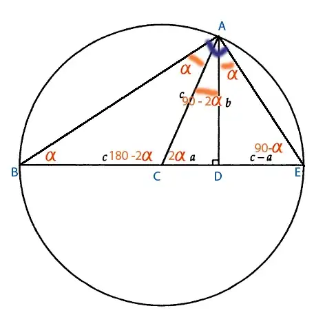

I will try to complete the answer of @Rick. The two triangles ABD and ADE are the same because both have the same angles 90, alpha and 90-alpha.
And we have $Cotangent(alpha) = \frac{BD}{DA} = \frac{AD}{DE} = \frac{c+a}{b} = \frac{b}{c-a}$
ihebiheb
  • 225
  • It is not so clear why $\angle BAE = 90 ^\circ$ but we can use several relations for this. $\angle ABC = \angle BAC$, $\angle CAE = \angle ACE$, $\angle BCA + \angle ACD = 180 ^\circ$, $\angle CAD + \angle ACD = 90 ^\circ$ and $\angle DAE + \angle AED = 90 ^\circ$ – Sextus Empiricus Mar 03 '20 at 22:28
  • It is the Thales's theorem : if A, B, and C are distinct points on a circle where the line AC is a diameter, then the angle ∠ABC is a right angle. (https://en.wikipedia.org/wiki/Thales%27s_theorem) but thanks for your clarification. I think you just proved this theorem – ihebiheb Mar 04 '20 at 18:30
