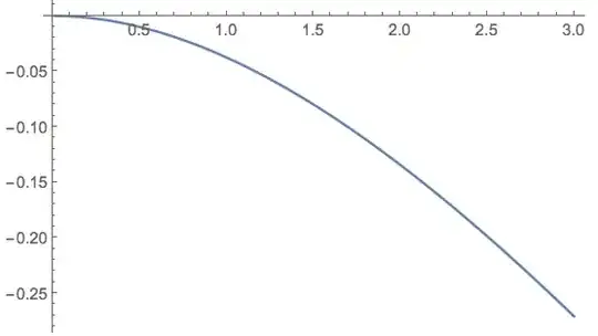

$\newcommand{\angles}[1]{\left\langle\, #1 \,\right\rangle} \newcommand{\braces}[1]{\left\lbrace\, #1 \,\right\rbrace} \newcommand{\bracks}[1]{\left\lbrack\, #1 \,\right\rbrack} \newcommand{\ceil}[1]{\,\left\lceil\, #1 \,\right\rceil\,} \newcommand{\dd}{{\rm d}} \newcommand{\ds}[1]{\displaystyle{#1}} \newcommand{\expo}[1]{\,{\rm e}^{#1}\,} \newcommand{\fermi}{\,{\rm f}} \newcommand{\floor}[1]{\,\left\lfloor #1 \right\rfloor\,} \newcommand{\half}{{1 \over 2}} \newcommand{\ic}{{\rm i}} \newcommand{\iff}{\Longleftrightarrow} \newcommand{\imp}{\Longrightarrow} \newcommand{\pars}[1]{\left(\, #1 \,\right)} \newcommand{\partiald}[3][]{\frac{\partial^{#1} #2}{\partial #3^{#1}}} \newcommand{\pp}{{\cal P}} \newcommand{\root}[2][]{\,\sqrt[#1]{\vphantom{\large A}\,#2\,}\,} \newcommand{\sech}{\,{\rm sech}} \newcommand{\sgn}{\,{\rm sgn}} \newcommand{\totald}[3][]{\frac{{\rm d}^{#1} #2}{{\rm d} #3^{#1}}} \newcommand{\ul}[1]{\underline{#1}} \newcommand{\verts}[1]{\left\vert\, #1 \,\right\vert}$ With Abel-Plana Formula :
\begin{align}&\color{#66f}{\large\sum_{n\ =\ 0}^{\infty}\expo{-x\root{n}}} \\[5mm]&=\ \overbrace{\int_{0}^{\infty}\expo{-x\root{t}}\,\dd t} ^{\ds{\color{#c00000}{\root{t}\ \mapsto\ t}}}\ +\ \left.\half\,\expo{-x\root{t}}\right\vert_{\, t\ =\ 0} +\ic\int_{0}^{\infty} {\expo{-x\root{\ic t}} - \expo{-x\root{-\ic t}} \over \expo{2\pi t} - 1}\,\dd t \\[5mm]&=2\ \overbrace{\int_{0}^{\infty}\expo{-xt}t\,\dd t} ^{\ds{\color{#c00000}{1 \over x^{2}}}}\ +\ \half - 2\Im\int_{0}^{\infty} {\exp\pars{-x\root{t}\pars{1 + \ic}/\root{2}} \over \expo{2\pi t} - 1}\,\dd t \\[5mm]&={2 \over x^{2}} + {1 \over 2} +2\int_{0}^{\infty}\exp\pars{-\,{x \over \root{2}}\,\root{t}}\,{\sin\pars{\root{2}x\root{t}/2} \over \expo{2\pi t} - 1}\,\dd t \\[5mm]&\sim\color{#66f}{\large{2 \over x^{2}} + {1 \over 2} +\ \underbrace{\pars{\root{2}\int_{0}^{\infty}{\root{t} \over \expo{2\pi t} - 1}\,\dd t}}_{\ds{\color{#c00000}{{\zeta\pars{3/2} \over 4\pi}\ \color{#000}{\approx\ 0.2079}}}}\ x \quad\mbox{when}\quad x \sim 0} \end{align}
$$ \color{#66f}{\large\sum_{n\ =\ 0}^{\infty}\expo{-x\root{n}} \sim {2 \over x^{2}}\,, \qquad x \sim 0} $$
Here, we can see a plot of the difference $\ds{\sum_{n\ =\ 0}^{\infty}\expo{-x\root{n}} - \bracks{{2 \over x^{2}} + \half + {\zeta\pars{3/2} \over 4\pi}\,x}}$: enter image description here
Felix Marin
  • 89,464
