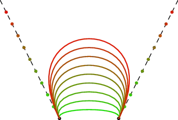

2) the tangents diverge on the same side. This case produces a "bubble". The farther away the B and C are, the larger the circle-like bump is. This kind of a spline is usually not something you want (at least in graphics), you have more control if you split it in half and get two "conventional" beziers. In any case, here, the curve is sharprer if AB and CD are smaller, but varying these parameters makes drastic changes in the shape.

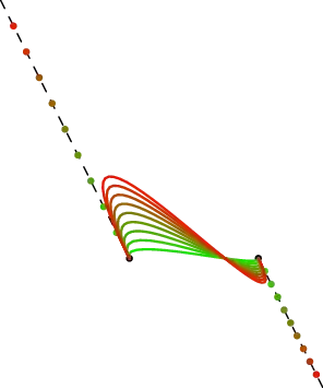

3) the tangents point in opposite directions (the curve intersects the A-D straight line). This is a horrible case (S-shape). Still, you can only vary AB and CD distances if you want to keep the tangents, so you can vary them until you honor the condition. This case again has subcases (like the two above), depending on whether the angles BAD and ADC are obtuse or acute.
I hope this helps. Essentially, you have two free parameters that you can vary in order to minimize sharpness. It also makes sense (to preserve the general shape) to keep the ratio AB/CD fixed and scale the distances simultaneously. Then you have a 1-parametric case which you can solve algorithmically without ambiguity (in 2-parametric case, you have too many solutions).

My suggestion was to "correct" your control points as such: $$B_u=A+(B-A)u$$ $$C_u=D+(C-D)u$$ where you are looking for $u$ which minimizes your maximum curvature. $u=1$ is your original curve. This parametrization lets you keep the approximate shape of the curve.
The first case (including the intersection of AB and CD lines) for multiple $u$ The second case for multiple $u$, see how the shape "inflates" The third case, two extremal points
