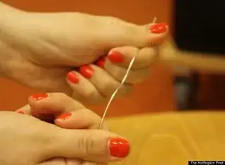

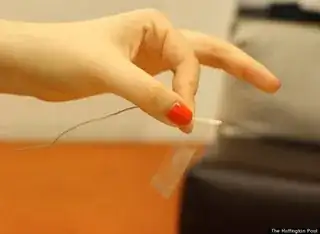

This can be done quickly and easily with a paper clip and scotch tape:
  1. Flatten out the paperclip.
  1. Tightly wrap scotch tape (with the sticky-side out) around the top part of the paperclip.
  1. Carefully insert the sticky end into the headphone jack.
Source.
