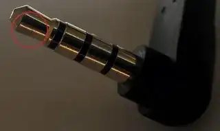

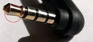

There are indeed some marks
Image 1 Image 2

Based on the pictures you edited into your question:
Here is a suggestion that should keep you going until you get the new cable; it's a hacky one too :)
Your picture shows nicely where the socket contacts engage the plug and wore away the (gold?, cadmium?) galvanised coating. If you could find a washer of some insulating material that would fit over the plug you would shift the contact points downwards by a distance equal the thickness of the washer. The socket contacts would touch areas of the plug that are not worn.
I would think the washer wouldn't have to be so thick as to shift the contact area entirely into the unworn area. Something like 0.2-0.3mmm is probably enough. Don't make it so thick that the bottom contact ends up too near the ridge, or the engagement mechanism won't work any more.
Instead of a washer you might have a thin o-ring?
You could easily make something out of some clamshell packaging or similar plastic. You could even use cardboard which is available in different thicknesses. Try to make the center hole not too big, so it sits tightly on the plug, i.e. doesn't fall off when you unplug the cable.
Once you found something that works, but tends to come off, just use some glue to hold it in place. Obviously try not to get any glue on the contacts and make sure the glue is dry before using it, so you don't get any inside the socket.

  • Many thanks for your answer! There are indeed some marks, I made some pictures of them, I put them in the post. Unfortunately I'm not able to get rid of them. :( I guess I'll order a replacement cable for my headphone. Do you maybe know if these marks are because of a faulty jack slot? I hope the new one won't get damaged over time. – otisonoza Oct 01 '17 at 12:16
    @otisonoza Great pictures, they show really well what happened here. I've edited an update into my answer. A follow-up idea that might work for you; to get you going until you get a new cable. – Flint Oct 01 '17 at 13:07
