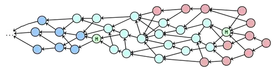

At the moment it is very simple to determine if a transaction is confirmed or not. If it's referenced (directly or indirectly) by a milestone, it is confirmed otherwise it isn't. In the future a transaction will be confirmed when it is referenced (directly or indirectly) by all tips.
In the picture, all blue transactions are confirmed, all red transactions aren't (yet). The green transactions are milestones. The darker blue transactions were confirmed by the first milestone, the lighter blue transactions were confirmed by the second milestone. A milestone also has to (directly or indirectly) reference all previous milestones.

  • I love your diagrams. I would just add a note that after the Coordinator is turned off confirmation is evaluated based on how many tips reference a transaction, it doesn't have to be all of them. >99% of new tips referencing your transaction would be very confident, but I'm not sure 100% is possible. – Matt Feb 21 '18 at 18:18

  • I think I spotted a mistake. How is the light blue transaction at the bottom confirmed and also the one it confirms left of it? I think these two should be red... – janowitz Mar 01 '18 at 22:36
  • Of course, you are right! I updated the pictures, it should be correct now. – Zauz Mar 01 '18 at 22:45
