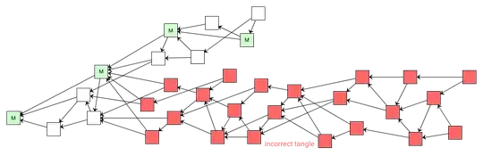

The IOTA network is very young. There are only about 1-2 transactions per second being made. It would be easy for an attacker to make a lot of transactions and make an incorrect tangle to a correct tangle.
This is one reason why the Coordinator exists. It issues transactions (called milestones) that only reference the correct tangle:
