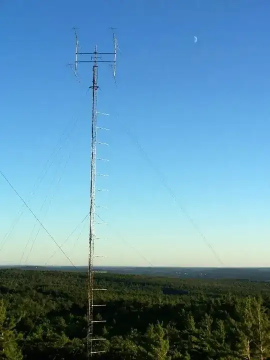

This 2 meter antenna array was built by Dave Olean K1WHS, in Maine (owner of Directive Systems and Engineering), a long-time 2m DXer and EME op. He had that stacked and phased very-low-angle array pointed down the east coast during a 2m contest a few years ago. IIRC, even with two different kinds of exceptional propagation enhancements taking place simultaneously, and the fact that some of the farthest stations that he worked was because some of the signals were over water, he never even made it all the way down the east coast*. And most of the 2m stations he was working had towers, high-gain arrays, and linear amplifiers as well!
*(Having said that, with that nice array Dave heard so many stations that it sounded like a contest on 20 meters! :-)
Now you see what kind of challenge you face if you want to work from coast-to-coast on 2 meters.
K1WHS stacked 2m array1 K1WHS stacked 2m array2
