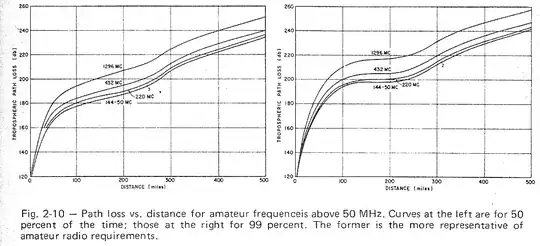

It goes on, after mentioning an article by D.W. Bray, K2LMG in the November 1961 QST magazine, to present two graphs that plot "tropospheric path loss" against distance. The curves therein rise steeply from 120 dB of loss at a distance of 0 miles [?!] to around 180 dB near 50 miles, then level off slightly so that at 500 miles there is a path loss around 240 dB. (That's reading the 50% reliability chart roughly, there's actually 4 lines plotted for 144/50, 220, 432, and 1296 MHz, as well as a second separate chart showing 99% reliability; the 99% reliability chart is very approximately 10–20 dB worse than the 50% one at any given point.)
UPDATE: thanks to W0BTU Mike, here's the actual charts scanned from an earlier edition:
Path loss vs. distance for amateur frequencies above 50 MHz

  • Here are some nomographs and accompanying text from an earlier version of the ARRL VHF Manual. Go to http://www.w0btu.com/files/vhf/ and download VHF_distance_coverage_nomographs.zip. I've found them to be a good predictor of VHF coverage back when I was operating SSB and CW on the low end of 2m back in the 1980s. And somewhat related is this webpage: http://www.w0btu.com/VHF-UHF_vertical_antenna_stacking.html – Mike Waters Mar 07 '17 at 15:14
    @MikeWaters Thanks, those are very similar to my edition! I've grabbed the chart I tried to describe and added it to my question, hope you don't mind. (Was on your site just the other day while researching beverage antennas and glad to meet you on this site now too!) – natevw - AF7TB Mar 07 '17 at 20:03
  • @natevw-AF7TB I don't mind at all! In August 2018 I converted the TIFF files to four PNG files there. Feel free to add those. – Mike Waters Oct 05 '18 at 18:38

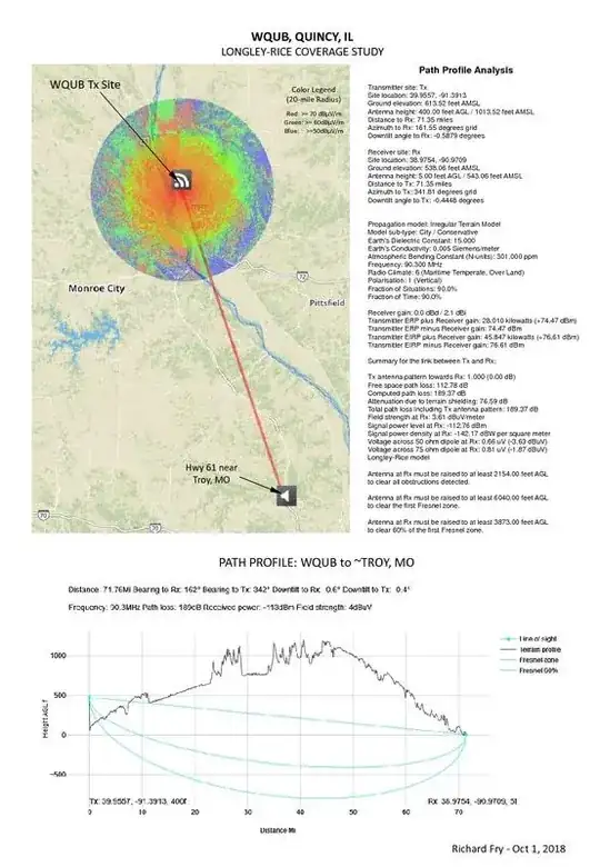

Terrestrial, point-point propagation paths can exist due to diffraction of the radiated e-m fields over terrain peaks and man-made structures, with each diffraction adding loss at the receive antenna to the normal inverse-distance field loss for an LOS path of that total length.
The graphic below illustrates this for an FM broadcast station, where the line-of-sight path is severely obstructed, but the signal can be received well beyond those obstructions.
The real propagation path would consist of several straight-line segments over terrain peaks, joined together to connect the transmit and receive antennas.
In this example, the additional loss due to diffractions compared to an LOS path of that total length is shown to be 76.59 dB.
The received field will vary over time depending on atmospheric K-factor and other conditions. enter image description here

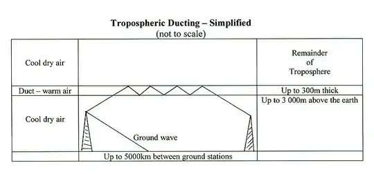

Tropospheric Ducting
A genuine duct consists of three layers of air.
They can be spectacular and extend over a greater distance, but are rare.
A true tropo duct almost never covers an area anywhere near as large as a temperature inversion. By *waveguiding" I assume that Marcus means "tropospheric ducting".
Below is what a duct looks like. More details can be found here.
Tropospheric duct
