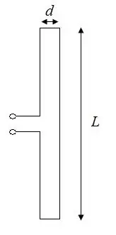

A Further Edit: A folded dipole is a dipole antenna with the ends folded back around and connected to each other, forming a loop as shown below:
The folded dipole antenna is resonant and radiates well at odd integer multiples of a half-wavelength (0.5λ, 1.5λ, etc.), when the antenna is fed in the center like a regular dipole. It can be made resonant at even multiples of a half-wavelength ( 1.0λ, 2.0λ, etc.) by offsetting the feed of the folded dipole (closer to the top or bottom edge of the folded dipole in the picture).
So you could make an off-center fed folding 80m dipole that will also be resonant on 160m. The feed point impedance will be higher than for a typical dipole, but that's usually not a problem.

    A resonant folded dipole is not half the size as an ordinary dipole -- it is the same size, with twice the wire. That is, in the figure you have, $L=0.5\lambda$, total wire length $=1\lambda$. Also, the trick you mention of offsetting the feedpoint to get resonance at even harmonics works with ordinary dipoles also. – Phil Frost - W8II Nov 21 '13 at 22:45
  • Also, the higher impedance is a problem. It's a lot higher, like four times higher. You will need a 4:1 balun to get a reasonable match to $50\Omega$ coax. – Phil Frost - W8II Nov 21 '13 at 22:48
  • @PhilFrost I wasn't clear in my edit, when I am awake, I'll try to tweek it. My point was an OCF folded dipole for 80m could give the OP a reasonably efficient antenna on 160m. He might need a 4:1 balun, it depends on how high he can get it. But, I don't consider matching 4:1 to be a problem. It's almost the same level of effort as the 1:1 balun you'll want anyway. – WPrecht Nov 22 '13 at 02:57
  • Phil, is your comment regarding a 4:1 balun in regards to a trapped dipole or a folded dipole? – Marcus Nov 22 '13 at 15:09
  • @Marcus folded dipole. If the traps are working as they should, the feedpoint impedance is not significantly altered from an untrapped antenna. Folded dipoles have four times the feedpoint impedance of dipoles, traps or not. – Phil Frost - W8II Nov 22 '13 at 16:01

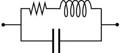

There are many kinds of traps, but the most common kind is a parallel LC circuit:
Source: article from w8ji.com
At resonance, this circuit presents a high impedance. At all other frequencies, it presents a low impedance. So, an 80/160m trapped dipole will be an 80m dipole, with traps at the end of that, with additional wire to resonate it at 160m. To 80m, the traps look like high impedances, effectively disconnecting the extra wire for 160m.
The traps themselves will shorten the amount of wire necessary to achieve resonance at 160m, similarly to a loading coil. However, they don't shorten the 80m section of the antenna. If you barely have enough room for an 80m dipole as it is, you need some additional shortening action.
Easiest is probably to bend the antenna to make it fit. You can stick a 90 degree bend in the antenna and it will still work. The tuning will be somewhat changed, but not radically. You could also add additional loading coils or hats, though these are somewhat harder to construct.
Another option, if an 80m dipole is already very close to your maximum size, is to put up a simple 80m dipole, forget the traps, and instead have a tuning network near the feedpoint that you switch in (or isolate with filters) for 160m operation. The advantage to a trapped antenna is the additional length on the longer bands maintains higher efficiency there, but if your 160m sections are extremely shortened then you aren't gaining any efficiency, but you are making the antenna difficult to construct and tune. If you put loading coils in the 80m sections then you shorten the whole antenna, but compromise performance on 80m when you don't need to. If you have a low-loss feedline, you can even do this with a tuner in the shack, especially considering how low feedline losses can be at 160m.
