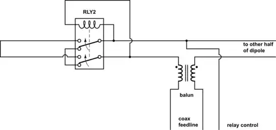

I've never done this, and I can't find descriptions by anyone who has, but I might try using twin-lead as the antenna element. The common-mode current radiates as a dipole normally would, while you can use the differential mode to control a DPDT relay.
The trouble then is the mechanism to control both common and differential modes from the shack. You don't want to put common-mode RF on the feedline: that would make it an antenna. If only you had a 3rd wire...
If you use a folded dipole, you can make one. At the center of what would normally be the undriven element is "ground". You can just attach a wire there. And if "ground" is actually DC +12V, you can use that to control the relay coils.
schematic
simulate this circuit – Schematic created using CircuitLab
Of course you'll need to impedance match the folded dipole somehow, like a 4:1 balun.
