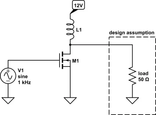

Let's give a very simple example to illustrate: a very simplified class-C common-source amplifier. You've probably seen such amplifiers with a resistor in place of L1, but for power amplifiers it's more common to use inductors to avoid the associated resistive losses.
schematic
simulate this circuit – Schematic created using CircuitLab
When the transistor is on, current through L1 increases and L1 stores energy. Let's say it's on long enough for current through L1 to rise to 1A. When the transistor is off, the voltage across the load will rise to 50V, because that's what it takes for 1A to pass through 50Ω. So we need M1 to have $V_\text{ds(max)} > 50\:\mathrm V$.
What happens if the load is open? Since no current can flow through the load, the voltage will rise even higher, whatever it takes to get 1A to continue flowing through L1. In this case it will be whatever voltage causes M1 to go into avalanche breakdown. RF power transistors aren't usually avalanche rated, so this means damage.
You can imagine other situations that lead to excessive drain current in M1 as well.
Of course, a real transmitter will be more complicated. It will probably have a low-pass filter on its output, multiple transistors with complex impedances at RF, and more reactive components within for impedance matching and filtering. All these values are selected with the assumption of a 50 ohm resistive load. Which load impedances will cause failure depend on the particular topology of the amplifier.

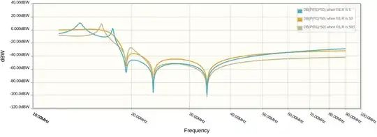

Ultimately, it is impedance mismatch (really, too low an impedance) that damages transmitters. The thing to realize is the impedance seen by the final power transistors in the amplifier (the part that usually breaks) isn't the same impedance at the amplifier's terminals.
The reason is that amplifiers contain filters on their output to filter harmonic suppression, among other things. These filters are designed with the assumption of a 50Ω resistive load. When that assumption holds, the filter presents the design impedance to the finals, which the designer has determined will not smoke the transistors.
When the load is not 50Ω, the design conditions are violated and the impedance presented to the finals could be anything. If you get lucky, it will be a high impedance which just means the amplifier can't deliver its full rated power. If you get unlucky, it's a low impedance which draws too much current and overheats the transistors. It's hard to predict where you will get lucky, and where you will get unlucky without knowing the details of the transmitter's filters. Here's an example from Is there an optimum transmission line length for maximum power transfer?
This is a 30/20m filter, so it is intended to pass up to about 14.4 MHz and attenuate all the higher harmonics of that. The orange line shows the case where there's a matched 50Ω load, while the blue and tan lines show 500Ω and 5Ω loads which are two cases of a 10:1 SWR.
Notice how the mismatch introduces peaks in the frequency response. Where these peaks are above the orange line, the amplifier is seeing a lower impedance, thus a higher current and more power. Here's the potential for damage. One of those blue peaks is right at 14 MHz and is about 10dB above the orange line. So on 20 meters, a 100W amplifier is suddenly trying to produce 1000W into a low impedance, which will quickly damage it.
There are any number of impedances which will result in a 10:1 SWR, and depending on the transmission line you might get any of them. I suggest checking out a Smith chart tutorial to get familiar with how this works.
This is why SWR is used to quantify the quality of the match: it is independent of transmission line length. For any given SWR, the height of those peaks in the graph above are about the same, and moving around different impedances with the same SWR just changes where they lie. Since you really don't know where they lie in practice, it's just best to avoid high SWR generally.
