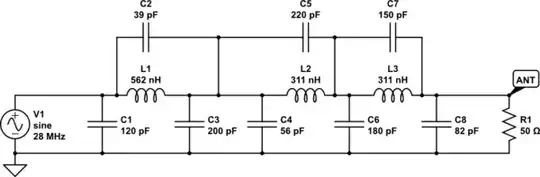

Let's look at the schematics for the Alex-TX board of HPSDR for an example. Here's the 20/30m transmit filter. R1 isn't part of the filter, but the impedance seen by the transmitter, which we will vary.
schematic
simulate this circuit – Schematic created using CircuitLab
Here's the power dissipated in R1 (that is, RF power radiated) as a function of frequency. Shown is what happens at 5, 50, and 500 ohms, normalized to the power that would be expected at a given voltage into a 50Ω load:
The orange line is a 50Ω load. You can see the filter makes a good low-pass filter, with a steep cutoff above the 20 meter band, effectively suppressing harmonic distortion.
However, look at the peaks and valleys introduced by the mismatch. One of those peaks in the 5Ω case is at 14 MHz, so on 20 meters it looks like you get an extra 10dB of transmit power with this particular filter and load.
That might seem like a good thing, but that power isn't free: it comes from your transmitter. That means the transmitter will be asked to deliver a lot more current, and probably overheat if it lacks appropriate protection.
The reactive 10:1 SWR cases fall around (9±49j)Ω. Unfortunately, CircuitLab doesn't provide a way to model a complex impedance, but it's basically the same, except the peaks and valleys fall in different places.
There's another issue as well: since the filter is made of resonant, reactive components, there is a potential for very high currents or voltages to develop in there if you start messing with the load impedance. So although in these 10:1 conditions the power in the transmitter and the load are identical to the 1:1 case, that doesn't mean the current and voltages within the filter are the same. High currents will overheat or saturate inductors, and high voltages will arc.
