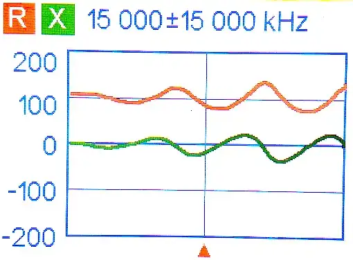

Well, I've got a piece of speaker wire handy (30 ft or so, 16 AWG). I unplugged it from my speaker and plugged it into a resistance decade box and my antenna analyzer, and made some measurements. Impedance, 0-30 MHz:
Impedance chart
So, an adequate piece of transmission line around 110 Ω.

I'd guess that the practical reasons not to use speaker wire are:
  • It's not a standard impedance, so you'd need matching on both ends
  • Any particular product might have a different impedance
  • It's not coax, so you have to treat it like any twin-lead and keep it away from other things, but people generally prefer coax unless they're building a high-performance HF station, at which point why use the cheap stuff?
