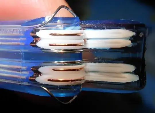

For higher-rate digital busses, twisted pair, as nice and cheap it is, doesn't do well enough anymore (see the attenuation of roughly 36 dB at 250 MHz sent over 100 m of twisted pair; you're losing literally 99.975% of energy in the cable) – the typical "cheap" (as in: 16€/m) direct attach copper for the next faster 10GE (10GBase-CR) uses Twinax - which is exactly that, a balanced line within a shielded, well-specified dielectric (same goes for SATA 6b/s, where this picture is from):
https://en.wikipedia.org/wiki/Serial_ATA#/media/File:SATA3-TwinAxCable.jpg
That way, up to 3.125 Gigabaud are possible. So yeah, for digital baseband, balanced line is used up to the multiples of GHz, but it's not cheaper than coax – in fact, it's the noise immunity considerations of differential signaling that led to the usage of twinax instead of simple coax. For an antenna, simple coax would have the same effect.
