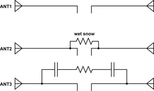

A heavy coating of ice or snow is likely to short the feedpoint of the antenna. Compare:
schematic
simulate this circuit – Schematic created using CircuitLab
Even if the wires and feedpoint are protected by insulation and the ice isn't directly touching, a thick coating of ice will make a tube around the wires, and the resulting capacitive coupling is a low impedance at RF. (ANT3)
Snow or ice isn't a great conductor, but it's a much better conductor than the air or PTFE insulator that was between the halves of the antenna. Clearly the antenna impedance, and thus the SWR, will be affected.
The change in temperature, dielectric constant, and other things mentioned in other answers do affect the antenna impedance, but not to a very significant degree. I'd wager that 80% of the times you sit down in the morning after a storm to find the SWR is all messed up, it's because there's water in the feedpoint. The other 20% of the time, it's because the antenna is sagging into a tree or the ground or broken from the additional weight.
