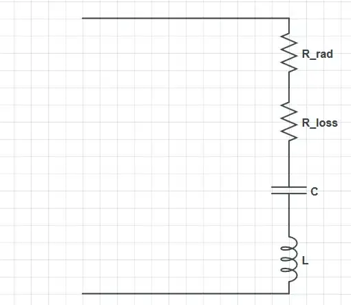

You can the behavior of an antenna with circuit model. The simplest circuit model for a resonant dipole would be a series RLC circuit. The circuit model transforms all impedances as they are seen in the feedpoint of the antenna. With the circuit model of the figure, the radiation efficiency becomes: $\eta = \frac{R_{rad}}{R_{rad}+R_{loss}}$, where $R_{rad}$ is the radiation resistance (power radiated to the far field) and $R_{loss}$ is loss resistance (power transformed to heat). $C$ and $L$ represent the reactive fields near the antenna.
Circuit model of $\lambda/2$ dipole near resonance.
OH2FXN

    I think worth pointing out that for that equation to work, all the resistances have to be normalized to the feedpoint (or any other one point). Since an antenna is an impedance transformer, a 1Ω resistance at an arbitrary point in the antenna may not appear as 1Ω at the feedpoint. – Phil Frost - W8II Jan 12 '14 at 15:13
