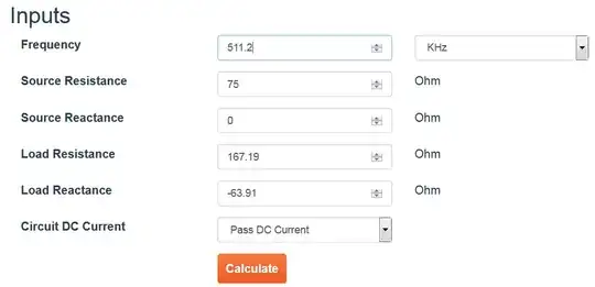

For example, let's use this calculator. From the data in your question, we enter the following information: enter image description here

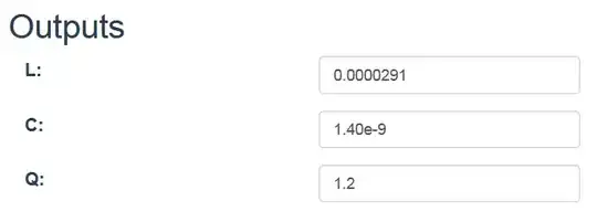

which produces the following results: enter image description here

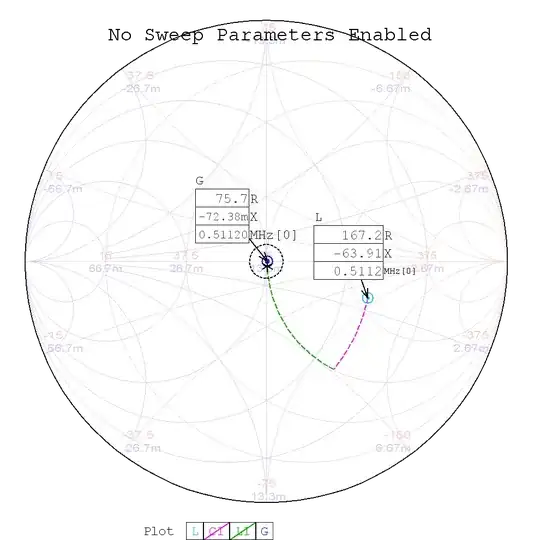

Using SimSmith to plot this transformation on a Smith chart: enter image description here
shows that the L-network provides a nearly perfect match to your transmitter.

  • @BrianK1L1. Because of my last comment above, should the entries into the calculator not change? INPUTS: Freq=511.2, Source Resistance=167.17, Source Reactance=-63.91, Load Resistance=75, Load Reactance=0. This produces OUTPUTS: L=2.91e-8, C=1.40e-12, Q=1.2 ?????? – B. Varner Apr 03 '19 at 21:08
