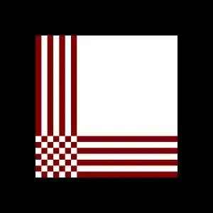

There are some good examples on http://www.flipcode.com/archives/Advanced_OpenGL_Texture_Mapping.shtml, here is a preview:
Wrap S : GL_CLAMP / Wrap T : GL_CLAMP
clamp clamp
Wrap S : GL_CLAMP / Wrap T : GL_REPEAT
clamp repeat
Wrap S : GL_REPEAT / Wrap T : GL_CLAMP
repeat clamp
Wrap S : GL_REPEAT / Wrap T : GL_REPEAT
repeat repeat
