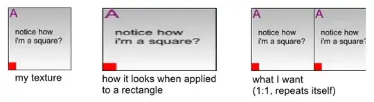

I'm not asking about how to map the texture itself. I'm just wondering how I could go about evenly mapping a texture to an object so that it repeats itself instead of stretching to the surface.
For example: A rectangle with the texture stretching to each corner, and a rectangle with the texture repeated without losing its original aspect ratio.
Thanks.

If you know you're spawning a quad with width and height
and you want your texture to spawn its entire height exactly once
and you want the width to truncate/repeat accordingly to preserve the texture aspect ratio
then you want your UV x values to run from 0 to width/height
and your UV y values to run from 0 to 1
This way if width is twice as large as height, your texture will tile two times horizontally. And correspondingly for other sizes.
