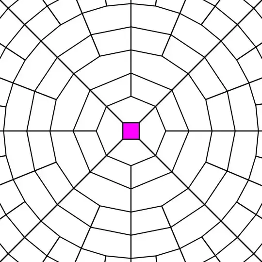

After 9 years I found nicer solution.
Since the world do not need to be ideal we can a bit "cheat" by allowing some error from ideal cube. Jordan Peck has proposed solution like this:Structure
If we take just a splice of this solution we can create spherical worlds without "space folding".
Demo and more videos can be found here: Jordan Peck home page
