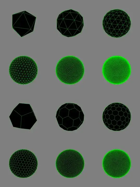

Here is an image showing the result of my icosahedron subdivision and dual mesh switching using half-edge data structure.
I may do a few iterations of relaxation to get the cell areas even more uniform.

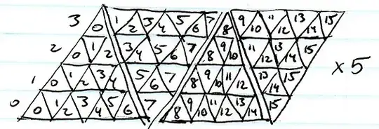

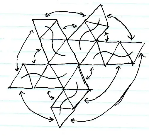

There is a way to do this rather elegantly based on subdividing an icosahedron, as you suggested in your question. An icosahedron is made of 20 equilateral triangles, and these triangles can be grouped into 5 sets, where the 4 triangles in a set form a parallelogram shape:
(The groups of four triangles with a squiggle drawn through them are the parallelograms I'm talking about. The arrows say which edges would be glued together to fold this up into an icosahedron.)
If these triangles are subdivided into smaller triangles, the whole parallelogram can be indexed like an n by 4n rectangular array (n = 4 in the example):
The numbers in each cell are the column numbers of the rectangular array. The rules for finding neighbors within the array are fairly simple: the horizontal neighbors are just plus or minus 1 column, while the vertical neighbor is either minus one row and plus one column, or plus one row and minus one column, depending on whether the column number is even or odd, respectively.
However, you still have to write some special-case code for finding neighbors that cross the boundary from one parallelogram to the next. It's a bit tricky since in some places, the top or bottom of one parallelogram will be connected to the side of another, or the top and bottom will be connected with a horizontal offset between them, etc. Possibly a half-edge structure or similar for the parallelograms would be useful here. However, at least the relationships are symmetrical amongst all 5 parallelograms: they all follow the same pattern in which side is connected to which other side of their neighbors.
