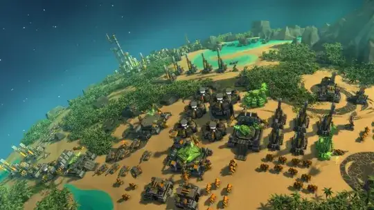

If it were a true sphere, we'd be able to see hills and objects sticking up from the edge of the planet. For example, here's Planetary Annihilation, see the trees and cliffs jutting out over the horizon:
