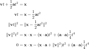

Let x be the position of the target relative to us, and let v be our (the projectile's) velocity relative to the target. The speed ||v|| of the projectile and the acceleration vector a are constant. We set up the usual equation of motion:
Final equation of derivation: 0 = x.x - (x.a + ||v||^2)*t^2 + a.a * t^4 / 4
This is now simply a biquadratic equation, which we can solve for t^2 with the usual quadratic formula, and take the square root again to get t:
t=sqrt((x.a+||v||^2 +- sqrt((x.a + ||v||^2)^2 - (a.a)(x.x))/((a.a)/2))
The lesser and greater positive real roots are the minimum (shallowest) and maximum (steepest) flight times of the projectile, respectively. Both of these will exist if there is any solution. We can then just plug them back into v=x/t-1/2 * a * t to recover the actual velocity vector. We're normally looking for the minimum flight time solution, but if e.g. there's a hill in the way, the maximum time solution might be able to shoot over it.
