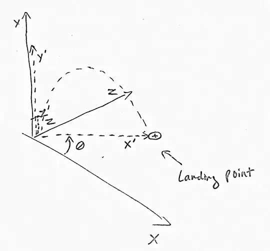

    I won't write this as an answer as I hope someone can give a more thorough response, but you can use the 2D solution in 3D. The 2D solution applies to the vertical plane that runs through the start and end point, so you take the 2D solution and rotate it to match that plane in 3D space. – Kylotan Aug 08 '12 at 23:16

To expand on Kylotan's comment, You can use the 2D formulas in 3D. Assuming Y is up:
calculate the position of the target in X'Y'Z' space, where the X' axis is parallel to the arrow flight direction, Y' axis is up, and Z' is perpendicular to the X' and Y' axes.
diagram
Once you have X' and Y' calculated, you can convert back to real XYZ-space
Example
An archer is at (1,0,1). He wants to shoot an arrow to (4,0,5). We take X' to be the unit vector (0.6, 0, 0.8) since it points directly from the source to destination point. We then take Z' to be (-0.8, 0, 0.6) because it is a perpendicular, but since the arrow doesn't move in the Z' axis, we will ignore it. Your problem is now figuring out how to shoot an arrow from (0,0) to (0,5) in X'Y' space.
.. do 2D calculations here. Note that you'll probably want parametric functions of X' and Y' in terms of t, the time variable.
One way to abstract the conversion between the two coordinates is to use a transform matrix.

when we convert back from X'Y'Z' to XYZ, this is simply a reverse linear transformation.
let inverse = Matrix4d.Invert(transform)
Vector3d.Transform(Vector3d.Zero, transform) // transforms (0,0,0) to (1,0,1)
