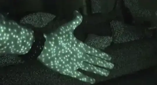

For my studio, I bought a Xbox Kinect sensor which can be used to create 3d point clouds in real time, which can be later converted into animations or 3d meshes (cheap 3d scanner). It works the way that it sends thousands of small points, not visable to the eyes that are later tracked by the sensor. From these points the camera projects a 3d point cloud which can be later transformed into meshes.

Before you actually get a Kinect, for these $150, you should try to borrow it from someone, and see how the software works on your pc. It literally eats 30mb of disk space per second + something must process this, a dual core pc wont handle this.
