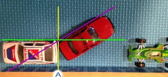

Imagine the scene in the image above. You have to help your friend in the red car to parallel park into a tight spot. 'Bump parking' is considered rude where I come from, so you want to position yourself where you can see clearly if is getting too close to the white car.
You are probably going to position yourself close to 'A' and look along the yellow line. If you look that way and see daylight between the two cars, you know they are not touching. If the cars get VERY close, then looking along the yellow line is the only way to spot the very moment of collision.
What we are doing here is looking along the rear edge of the white car.
How did we know to look along that particular edge? In the real world we use our intuition. We know that looking along the purple line [long edge of the red car] or the green line [long edge of the white car] will not help in this situation.
But a computer doesn't have intuition, so we will ask it to "look" along all edges of both objects. If it finds a gap along even one of those edges then there's no collision. If it finds no gap on any of those edges, then that means the objects have collided.
