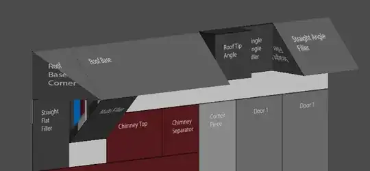

Below is some shots of my template sheet and workflow I have been doing. Should I do the roof separately or is it possible for me to keep it in the same texture sheet?
The main issue is below. I have made a couple modular roof pieces but when i try to use them, i end up needing to model multiple other parts to fill gaps based on what roof shape i want. I then model those 'filler' pieces and now i have that much less space left in my texture sheet and those pieces are usually not that reusable for anything else. This is where im not sure how to proceed.

My main roof pieces with the gaps enter image description here

    I'm a little confused as to what the problem is. When modeling tile systems I just look at legos. Pretty much everthing works as long as you are able to determine the right angle for each piece. I'm not really sure why you need filler bits. You should be able to make everything with a roof corner pyramid, roof side tube thingy (what you call "roof base"), a flat piece for the top, and I guess a chimney cube. Sorry if I am not really understanding the issue, but it doesn't look like you really have a problem with your system. Maybe you are just over thinking. – Benjamin Danger Johnson Nov 13 '12 at 22:35
If you are having trouble conceptualizing the modular pieces you need to create for buildings, I would recommend that you look to Lego. It will serve as both a practical example you can keep on your desk and is already highly modular.
