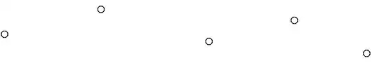

Step1: Randomize points-each time taking a step forward on the x-axis
Randomize points

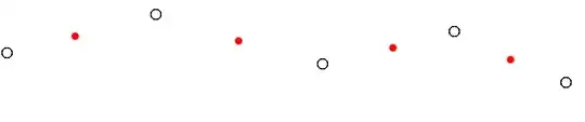

Step2: Imagine segments(lines) between these points, add new points in the middle of each one Draw segments and midpoints
This is how it looks now without the segments: enter image description here

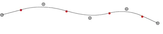

Step3: Draw bezier from red point to red point, using the original point as control. enter image description here

You can use Beziers here to create a smooth continuous curve ... first randomize a continuous list of points:
//screen size 640 x 480
safeViewDistance = 700; //How far can the player see
playerX;
averageDist = 100 // averageDistanceBet
lastX = - 2.5 * averageDist //the further point in the tunnel
tunnelHeight = 300 // space between ceiling to floor
while(lastX < playerX + safeViewDistance)
    lastX += (0.5 + Math.random()) * averageDist;
    points.push(new Point(lastX, Math.random());
//to draw the ceiling and floor use bezier:
lastDrawnPoint = 1;
function drawPoints(yOffset, yCoeff)
    while(lastDrawnPoint < points.length)
        i = lastDrawnPoint;
        startPoint = average(points[i-1], points[i]);
        controlPoint = points[i];
        endPoint = average(points[i],points[i+1]);
        startPoint.y *= yCoeff;
        startPoint.y += yOffset;
        /repeat for control and end
        drawBezier(startPoint, controlPoint, endPoint);
Drawing a Bezier approximation can be handled by iterating with n = 100 on the function and drawing lines:
q(t) = (1-t)*((1-t)*start + t*control) + t*((1-t)*control + t*end)
By iterating I mean running on 0 <= k <= n like this:
q(k/n)
