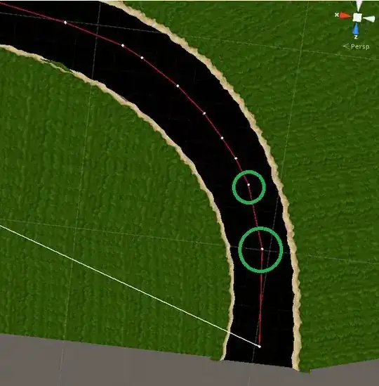

As solution, without other tools, you can consider to start (smoothely) turn to next waypoint before you reach the current target waypoint.
Hope the image clarify my idea. When you reach the green circles (the size can depend on waypoints distances) start to turn versus next waypoint
dnk drone.vs.drones
  • 3,460
  • 26
  • thats pretty good solution, will implement it and let you know – idurvesh Sep 01 '15 at 12:30
  • If I've understood correctly, that would look like the vehicle is sliding awkwardly because it will rotate without changing it's velocity. – AturSams Sep 20 '15 at 23:55
