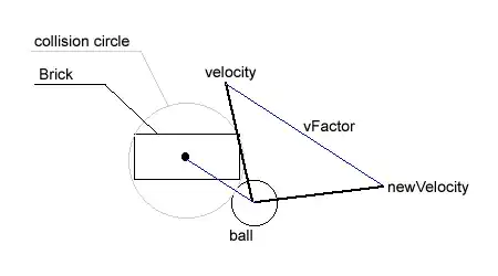

Here is some pseudo code that will accomplish this. I'm assuming ball vector represents the position change (velocity) of the ball.
Vector collisionUnitVector = blockCtr - ball.GetLoc();
float cuvLength = collisionUnitVector.Length();
collisionUnitVector /= cuvLength;
Vector Velocity = ball.GetVector();
float speed = velocity.Length();
Vector velocityNormal = velocity / speed;
float dotProduct = Dot(collisionUnitVector, velocityNormal);
Vector vFactor = 2 * (-collisionUnitVector * dotProduct * speed);
Vector newVelocity = velocity + vFactor;
alt text

  • Jake, do you need some code to do the dot product function. If so, we can do that too.
    To make it a little more robust, you could normalize newVelocity and scale it by speed.
    – Steve H Sep 01 '10 at 05:42
  • Took some adapting as expected but is working now. Thanks for the help. Diagram was awesome. – Jake Wharton Sep 02 '10 at 03:22
  • You're welcome. I don't know java so I had to go to semi-pseudo code. Glad you got it. – Steve H Sep 02 '10 at 04:36
