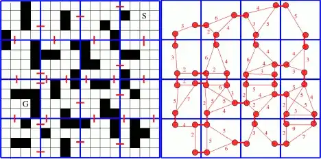

I don't know if this is definitely how he prevents "flooding the map", but the usual way to do this in games is using an alteration to A* called Hierarchical Path-Finding A*, or HPA*. The idea is to break the grid into many fewer but larger chunks, then use A* to find the best path from each chunk to its neighboring chunks. You can use this to build a much smaller graph over which to run A* for each unit over.
Hierarchical pathfinding
You can also group those chunks into even larger chunks, which is where the "hierarchical" comes from.
This algorithm only finds near-optimal paths, but for games like Dwarf-Fortress that is usually ok. It is still guaranteed to find a path if one exists; and when there is no path, it will only flood-fill the smaller graph, saving an enormous amount of time.
There is also an abstraction of HPA* that deals with units which can go over some terrain but not others (such as cliffs, which air-units can traverse over but ground-units can't). It's called HAA*, and there is a very accessible article explaining it here.
