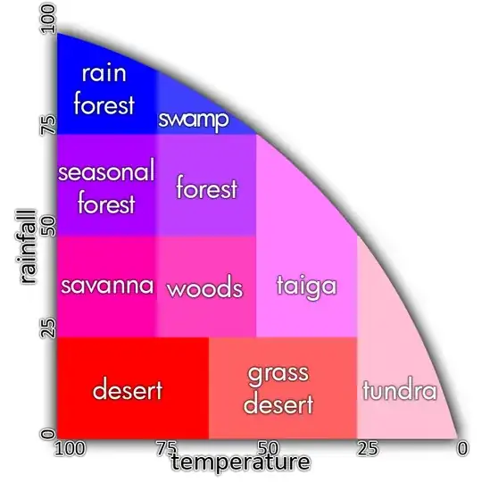

While not a tutorial, there's an article on how Dwarf fortress world maps are generated. Basically you generate multiple layers of noise, for height, moisture, temperature, salinity. Then you'd use something like this:
Or this
to generate biomes based on the layers of noise you produced before. Typically this gives a fairly smooth transition between biomes and the transitions are logical. I also modify the moisture and temperature maps based on elevation. This naturally generates a "timber line" and produces rocky mountains with snowy caps.

You can use Perlin Noise for the generation of the terrain, here is how the biomes in Minecraft work. As you can see he uses a heatmap in combination with a rainmap to create the biomes.
Biomes from Minecraft
