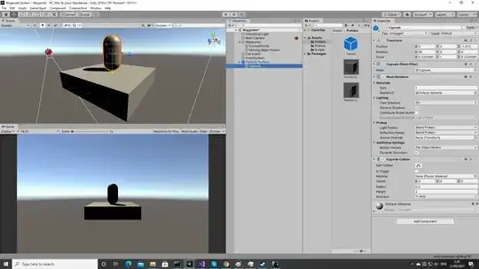

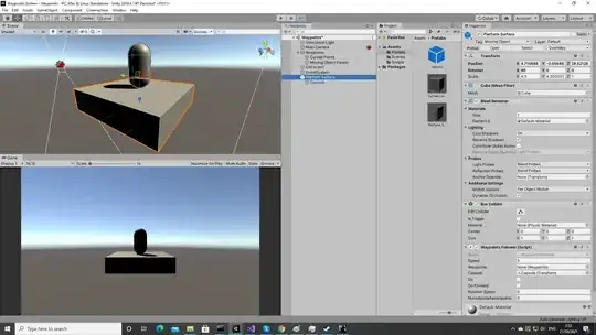

I have a parent cube and to make it like a surface I had to change the rotation of the cube on the X to 90. and as a child, I added a capsule, and to make the capsule-like standing I had to change the capsule X also to 90. The result is :
The reason I put the capsule child of the cube is that I want the capsule to move with the cube.
Platform rotation on the X is 90
The capsule rotation on the X is also 90 :
Capsule rotation on the X is also 90
