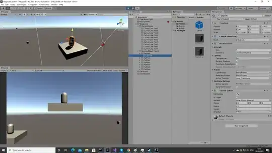

The Platform is moving along the waypoints. in the screenshot of the platform axis, the Red looks like facing forward the Blue facing down and the Green is facing to the left.
Platform axis
The capsule on each platform is kind of npc or player and his axis looks something else :
Capsule axis
I'm not sure what part I should rotate by logic if the platform or the capsule. in this case, I think the capsule should be rotating facing the next waypoint each time. The rotation should be while the transform is started moving.
This script is attached to each Platform. and in lines 77 and 78 I'm doing the rotation but for now I'm rotating the transform that's the Platform and not the Capsule so I should add a public variable to get a reference to each capsule. but anyway the rotation is not working I tried to run the game and the Platform is not rotating at all. but I think that I should rotate the capsule not the platform but not sure how to do it.
This is the lines 77-78 part :
transform.rotation = Quaternion.RotateTowards(transform.rotation,
                Quaternion.LookRotation(waypoints.lineRendererPositions[index]), Time.time * lookAtRotationSpeed);
The full script :

  • The reason why this problem appears to be more complicated than it seems could be because the platform is rotated by 90° on the X axis. It's "on the side". – Philipp May 20 '21 at 12:19
  • Time.time * lookAtRotationSpeed - sure that you don't mean Time.deltaTime here? – Philipp May 20 '21 at 12:24
  • Quaternion.LookRotation needs a direction vector, not a world position. You can get a direction vector by subtracting the current position from the position you want to look at. – Philipp May 20 '21 at 12:26
  • But all those mistakes should still cause some form of rotation, just not the rotation you expect. So when you see nothing at all, then there is some more crucial mistake. Perhaps in the waypoint management code. It's generally a good idea in software development to first try to solve a problem in a simplified and isolated situation, and then try to generalize the solution and integrate it into a larger architecture. – Philipp May 20 '21 at 12:29
