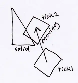

I'm trying to implement a collision system in a 2D game I'm making. The separating axis theorem (as described by metanet's collision tutorial) seems like an efficient and robust way of handling collision detection, but I don't quite like the collision response method they use. By blindly displacing along the axis of least overlap, the algorithm simply ignores the previous position of the moving object, which means that it doesn't collide with the stationary object so much as it enters it and then bounces out.
Here's an example of a situation where this would matter:
Example

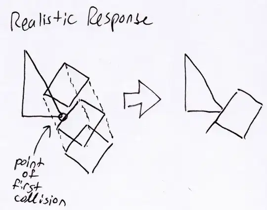

However, realistically, the rectangle should stop at the lower right corner of the triangle, as that would be the point of first collision if it were moving continuously along its displacement vector:
Realistic Response
Now, this might not actually matter during gameplay, but I'd love to know if there's a way of efficiently and generally attaining accurate displacements in this manner. I've been racking my brains over it for the past few days, and I don't want to give up yet!

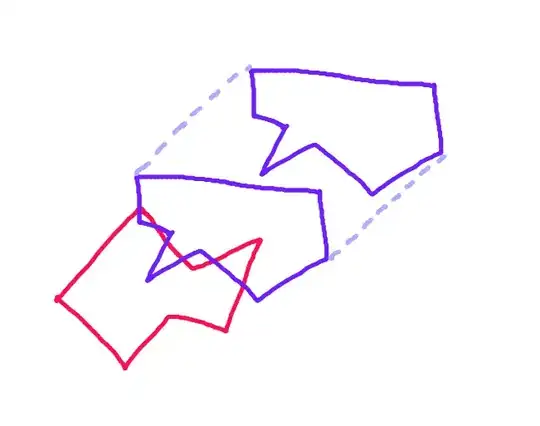

Here's the method I found. It might be flawed, but I haven't found any problems with it yet in my cursory analysis. It also works for arbitrary polygons with a few minor modifications.

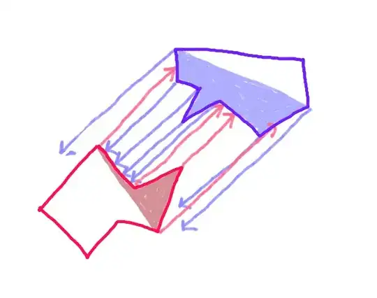

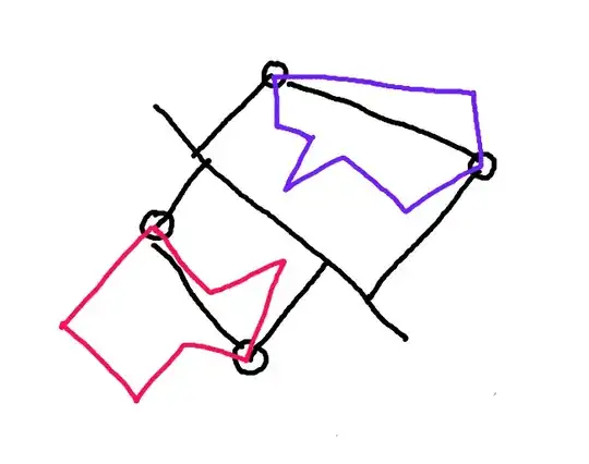

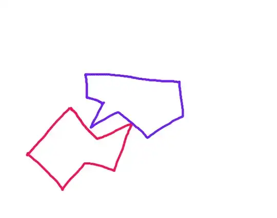

In the illustrations below, the blue object is moving and the red object is stationary. 1 Step 1: For each polygon, find the two farthest points along the projection of that polygon onto the line perpendicular to the motion vector. 2 Step 2: Divide each polygon along the line connecting these points. The half of the polygon that faces the other polygon along the motion vector is the "forward hull". This is the only part of the polygon that can possibly collide. 3 Step 3: Project a vector from each point on each polygon's "forward hull" along the motion vector towards the opposite polygon, and check it for intersection with each edge of the opposite polygon's "forward hull". (Possibly slow, but computers are pretty fast nowadays -- right?) (Sorry about the tilted arrow. All the arrows should be parallel.) 4 Step 4: Take the shortest vector. This is the exact collision distance. 5 Step 5: Voila! 6
