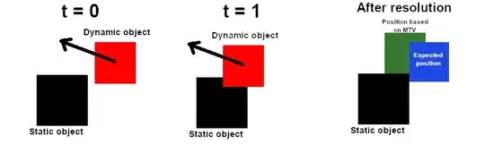

The minimum translation vector isn't a good choice when resolving collision. For example, let's look at the following case:
The three parts of the image show the three states of the physics engine given a static square and a dynamic one (for simplicity). The dynamic object enters the static one during the update. The minimal translation vector is always the shortest vector, that completely separates the two objects, but it's not always the correct one. The MTV here dictates, that the shortest path to separation is to move the dynamic object vertically upwards. This shouldn't happen, since it entered the static one from the sides and everyone would expect it to stop. This leads to the dynamic object essentially jumping across the static one.
If you want to separate the squares realistically, follow this answer
If you don't care, then it's pretty simple. Just take the smallest vector, multiply it by overlapDistance and subtract it from the position of the moving square
