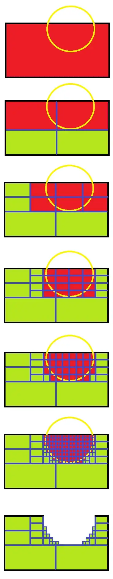

Okay, the naive approach is this: construct your terrain up of rectangles that are 1 pixel by 1 pixel (or, in the case of one of the 3D worms, of cubes). If you have a bullet, or an explosion, or any other source of destruction, then what you want to do is as simple as applying collision detection, and removing all of the rectangles/cubes that collide with the source of damage. The problem is, this is slow.
But, we can still use the idea behind this, if we're clever about it. The trick is: model the terrain as a larger rectangle. Then, when that rectangle collides with a source of damage, segment it into four smaller rectangles. And apply this recursively until you reach a necessary level of precision (i.e. 1 pixel, 2 pixels, 4 pixels, etc.) When you reach that level, remove all of the rectangles that are still in contact with your source of damage.
Here is an example of how it would look:
Example of terrain segmentation
Note, that for more complex terrain, you could expand this into other polygonal shapes. However, consider also, that with some thought, you can model the shape of your 2D terrain using procedurally generated rectangles. But that would be a bit of a different discussion to have.

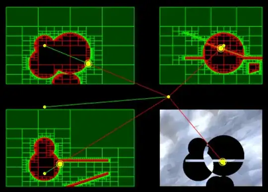

Old Worm games did use the pixel by pixel approach, but this was a bit more understandable in that era. Pixels weren't as dense and per-pixel collision was easy and fast (you could check whether two sprites collided during drawing). Modern Worms actually use something called marching squares or marching cubes. Instead of actual pixels, the map is made out of values between 0 and 1 in a specific density, then the algorithms take this and convert it to a mesh.

    Not true, they didn't simply use a 2D pixel array. See my answer: They used RLE, which was a common approach to such problems at that time. – Engineer Feb 25 '19 at 15:45

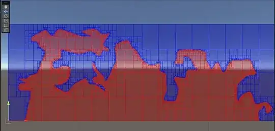

The simplest option is to implement a quad tree. Here is how it looks like: quad tree visual representation
Here is my implementation: https://github.com/hesmeron/Destructible2DTerrain
I went into detail on how it works on my medium tutorial https://medium.com/@hesmeron/2d-destructible-terrain-in-unity-using-quadtrees-09e99a161b96
But, basically you use spatial partitioning to effectively construct a mesh and access necessary data.
