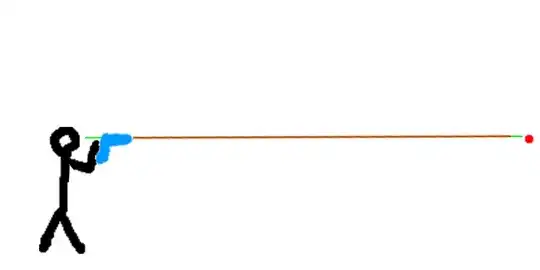

Lower gun aim

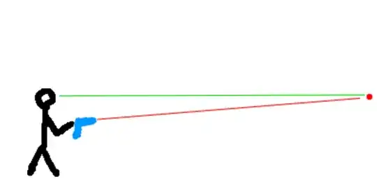

First, this is a representation of a player shooting from the hip. The red dot represents where the cross hair aim point. The horizontal green line is the view from eye to aim point (through cross hair). The red line coming from the gun is the actual bullet travel line.
Here is the same setup if the shooter is holding the gun up (iron sights). This is what's happening in the example you reference in the video at 5:17.

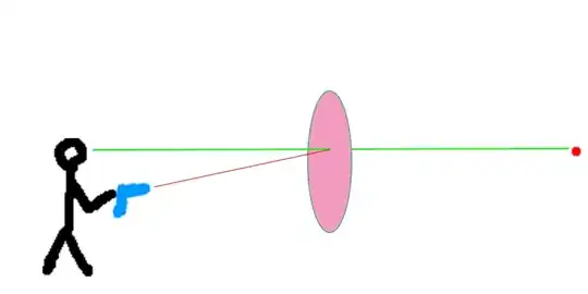

Now let's go back to the first case, but add a target that's in front of the player, and fairly close.

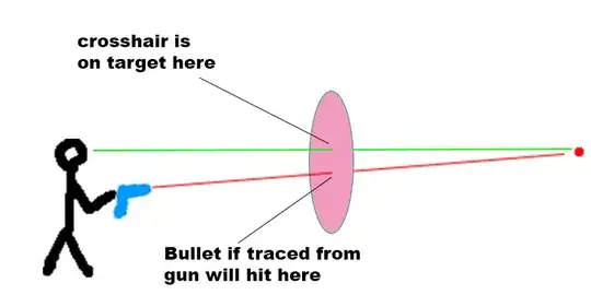

You can see now how where the cross hair looks like it's targeting and where the shot hits isn't the same. And that's a problem, because it might actually mean a miss if the hit boxes are more complex, or if you are rendering a hit decal at the impact point. Either the player shoots at what looks like a perfect target and misses, or the player shoots and hits, but the hit indicator isn't where they shot.

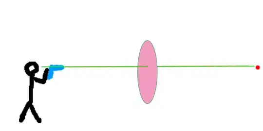

But of course if they are holding the gun up to their eyes (iron sights), it's just fine...

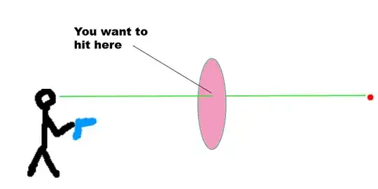

First, here's the problem we want to solve. We want to hit the spot that the cross hair is on, like this...
The first thing you need to do is calculate where the point is that your eye is on the target. In other words, calculate where the line drawn from eye to aim spot (cross hair) would hit.
Once you have this point, there are two things you should do.
First, when you draw the streak of the bullet, draw it from the tip of the gun to this newly calculated point...
It's not super clear in my illustrations, but the problem is though your gun isn't quite pointing the same way as the shot. And the closer the target is to you, the worse it will be. So the second thing to do is rotate the first person gun model up a bit so it's pointing at the impact point, like this...
And now, everything is all good!
