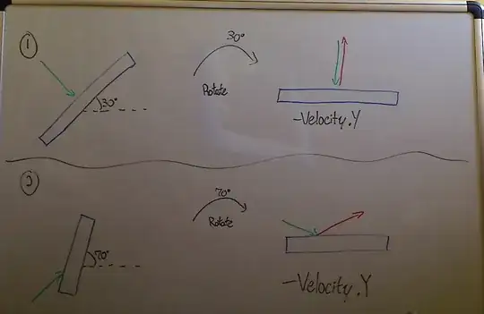

I'm not sure if I understood your problem correctly, but I assumed that what you want to do is find the resultant direction of you ball after a collision.
Here's a quick drawing on my white board that shows a possible solution for that:
The green arrows represent the ball's velocity (as a vector), the blue blocks represent your large black blocks and the red arrow is the resultant vector.
On the first case, the blue block has an inclination of 30 degrees. One of the way to fix the collision problem is to bring everything back on the horizontal axis. What you need to do is rotate everything by 30 degrees (the inclination of the block) (you can use matrices for that).
Then, you check where the collision was from. If the collision was horizontal, reverse the x component of the velocity. If it was vertical (like in this case), the y component (ball.Velocity.Y = -ball.Velocity.Y). This will also make the ball act correctly when it hits corners (it will reverse both components). After that, you just have to rotate back to the real situation (which is not on the drawing).
On the second case, it's the same thing, except that the ball's velocity is not perpendicular to the block. You rotate by 70 degrees, check where the collision was from, and reverse the appropriate components. After, you rotate back to your real situation.
Note: I noticed that you're using an angle to represent the direction instead of a vector. You could just create a vector for these calculations or keep the same general idea but working with angles.
This is certainly not the best way to go and I'm sure you can just calculate it in some way but I think it's a possible solution to your problem.

  • Thanks... Loved your board. I'll try in a minute... Ahn, and do you think that vectors could be better to maintain/work with?? – NemoStein Jun 16 '11 at 16:50
  • Haha pardon my poor drawing skills. – Jesse Emond Jun 16 '11 at 16:51
  • Oops, I actually forgot an important step while drawing.. You need to rotate back with -block inclination angle to have an appropriate collision response.. Silly me. – Jesse Emond Jun 16 '11 at 16:55
  • I guess it's about personal preferences, but I prefer vectors a LOT. You just don't have to think about the maths behind them most of the time and it usually makes code cleaner. So you could keep a Direction (as a vector) and update the position of the ball like so: ball.Position += ball.Direction * ball.Speed;. – Jesse Emond Jun 16 '11 at 16:56
  • @Jesse, I wasn't able to do this until now. I understood your method perfectly, but couldn't implement it. To do this I'll need to rewrite the whole part that use radian angles to use vectors (this isn't much, in fact). For now I'll try other alternatives, and if you have another one, I'll be glad to try. Thanks. – NemoStein Jun 16 '11 at 18:56
  • Thanks, @Jesse. Vectors made the point. The problem now is the direction of the collision. – NemoStein Jun 16 '11 at 21:41
