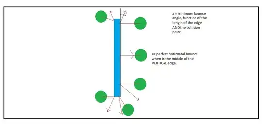

I would like to make a pong game with a small twist (for now).
  1. Every time the ball bounces off one of the paddles i want it to be under a certain angle (between a min and a max). I simply can't wrap my head around how to actually do it (i have some thoughts and such but i simply cannot implement them properly - i feel i'm overcomplicating things). Here's an image with a small explanation Bouncing angles.
  2. One other problem would be that the conditions for bouncing have to be different for every edge. For example, in the picture, on the two small horizontal edges i do not want a perfectly vertical bounce when in the middle of the edge but rather a constant angle (pi/4 maybe) in either direction depending on the collision point (before the middle of the edge, or after). All of my collisions are done with the Separating Axes Theorem (and seem to work fine).
  3. I'm looking for something efficient because i want to add a lot of things later on (maybe polygons with many edges and such). So i need to keep to a minimum the amount of checking done every frame.
  4. The collision algorithm begins testing whenever the bounding boxes of the paddle and the ball intersect. Is there something better to test for possible collisions every frame? (more efficient in the long run,with many more objects etc, not necessarily easy to code).

Something isn't working properly. The collision axis doesn't come out right and the interpolation also seems to have no effect. I've changed the code a bit:
private bool ShapesIntersect(Paddle paddle, Ball ball)
        overlap = 1000000f; //large value
        overlapAxis = Vector2.Zero;
        MTV = Vector2.Zero;
        foreach (Vector2 ax in Axes)
            float[] pad = paddle.ProjectPaddle(ax); //pad0 = min, pad1 = max
            float[] circle = ball.ProjectBall(ax);  //circle0 = min, circle1 = max
            if (pad[1] < circle[0] || circle[1] < pad[0]) { return false; }
            if (Math.Abs(pad[1] - circle[0]) < Math.Abs(circle[1] - pad[0]))
                if (Math.Abs(overlap) > Math.Abs(-pad[1] + circle[0])) { overlap = -pad[1] + circle[0]; overlapAxis = ax * (-1); } //to get the proper axis
            else
                if (Math.Abs(overlap) > Math.Abs(circle[1] - pad[0])) { overlap = circle[1] - pad[0]; overlapAxis = ax; }
        if (overlapAxis != Vector2.Zero) { MTV = overlapAxis * Math.Abs(overlap); }
        return true;
And part of the Update method:
if (ShapesIntersect(paddleRight, ball))
                        isColliding = true;
                        if (MTV != Vector2.Zero) { ball.X += MTV.X; ball.Y += MTV.Y; }
                        //test
                        if (overlapAxis.X == 0) //collision with horizontal edge
                        else if (overlapAxis.Y == 0) //collision with vertical edge
                            float factor = Math.Abs(ball.ballCenter.Y - paddleRight.Y) / paddleRight.Height;
                            if (factor > 1) factor = 1f;
                            if (overlapAxis.X < 0) //left edge?
                                ball.Speed = ball.DEFAULTSPEED * Vector2.Normalize(Vector2.Reflect(ball.Speed, (Vector2.Lerp(new Vector2(-1, -3), new Vector2(-1, 3), factor))));
                            else //right edge?
                                ball.Speed = ball.DEFAULTSPEED * Vector2.Normalize(Vector2.Reflect(ball.Speed, (Vector2.Lerp(new Vector2(1, -3), new Vector2(1, 3), factor))));
                        else //vertex collision???
                            ball.Speed = -ball.Speed;
What seems to happen is that "overlapAxis" doesn't always return the right one. So instead of (-1,0) i get the (1,0) (this happened even before i multiplied with -1 there). Sometimes there isn't even a collision registered even though the ball passes through the paddle... The interpolation also seems to have no effect as the angles barely change (or the overlapAxis is almost never (-1,0) or (1,0) but something like (0.9783473, 0.02743843)... ). What am i missing here? :(

  1. My suggestion to accomplish this would be to adjust the collision normal accordingly. You could have one normal at the top corner pointing, say 45 deg, up/right and one normal in the bottom corner pointing down/right. For any collision between these you can interpolate between these two normals (using Vector2.Lerp) to get an angle that will then point stright to the right in the exact middle of the edge. In case you want a region with perfect horizontal bounce you can use two normals on the borders of this region pointing in the horizontal direction.
  2. You can handle this by using different normals for different edges.
3 and 4. You are on the right track. In the future you can implement a sweep and prune algorithm to determine for which entities to make the broad phase collision detect. For your purpose there is no need for it right now as you only need to check the ball against all other entities which is a O(n) operation. If you have many moving entities which may hit each other you might need it as check all these against each other will be a O(m^2) operation (m number of moving entities that can hit each other)
EDIT: Note that when interpolating two unitvectors you are not guaranteed to get a unit vector back, it will probably be a little shorter. So make sure to normalize after interpolation.
EDIT 2: If you are interpolating along the vertical side then you want your amount to be zero when at the top and one at the bottom. This should depend on the y-value of the contact point.
float amount = (contact.Point.Y - top.Y) / (bottom.Y - top.Y);
Assuming that y is positive in the downwards direction (bottom.Y > top.Y). This will give a value for amount that is in the range of [0..1]
EDIT 3: To find correct contact points you will have two cases to handle. For ball-edge contact follow the reverse axis of collision (which is the edge normal) from the center of ball to the edge of the ball. That will be your contact point. You might have some overlapping due to movement from last frame and this can be handled by a special interpenetration handling method before handleing the collision. Remember to check if you actually have a closing velocity along the axis before handling collision or you might experience some very strange behaviour.
To find contact point for ball-vertex contact do the same thing but the axis in this case is the vecetor from the vertex to the ball center.
Mikael Högström
  • 1,705
  • Thanks! I'll try this too (combined with something from above) – X Y Aug 14 '12 at 10:45
  • Ok, stupid question: suppose i want the normal (-1,-3) for the upper corner and (-1,3) for the lower corner [for the right paddle and not considering normalization yet] - how can i determine when to actually reflect by it (i.e. when the ball "hit" one of the corners)? Do i need to make some kind of "phantom" edge tangent to the corner under what angle i want? – X Y Aug 14 '12 at 11:36
  • Ahh I forgot to metion that yes, you need to normalize since two interpolated unit vectors are not guranteed to be length one. I'm not sure I understand your question but for corner-ball collision you'll need a special case which differs a little from the edge-ball collision. As for the tangent for your edge-ball collision, yes in that would be a "pretend" normal that we calculate by interpolating between (-1,3) and (-1,3). – Mikael Högström Aug 14 '12 at 11:42
  • Ok,let me rephrase. How can i determine exactly when to reflect by (-1,3)[normalized] for example? (having a collision is one condition; what others should i put? anything related to the minimum translation vector?). – X Y Aug 14 '12 at 11:53
  • Basically how should i change the "amount" parameter of the interpolation according to where the ball hit the paddle? – X Y Aug 14 '12 at 13:42
  • Ahh ok now I get ya :) I'll edit my answer accordingly – Mikael Högström Aug 14 '12 at 14:20
  • Thanks! My real issue is with that contact point :) I cannot properly define it (per-pixel detection is costly and usually more than one pixel intersects). I don't know if it should be related to the MTV vector(as this is just a projection) but probably not. I need precision and a fast way to determine that contact but i think the former is not really possible due to the pixels. Any advice? – X Y Aug 16 '12 at 08:21
  • I've only done this in 3D so I might not be entirely right in every aspect. I'll edit my answer again to account for contact points :) – Mikael Högström Aug 16 '12 at 09:17
  • Thank you very much for your time and help. Tell me if what i write now is what you meant: so, i have a collision (overlap), i displace the ball according to MTV (velocity vector stays the same), now i need to check the collision point. Suppose the ball center is at (10,10) and radius = 3. This means that my collision point on the right edge of the left paddle is at (10-3,10), right? But the Y of this is always the ball's center Y. So i can always take this Y for vertical edges(and presumably the X for horizontal edges). This seems to work for vertex collision too,or i'm missing smth? – X Y Aug 16 '12 at 10:06
  • That's sounds about right. Just remember that you have another axis of collision for vertex-ball collision which is the vector from the vertex to the ball center. So instead of (10,10) - 3(1,0) you will have (10,10) - 3(x,y) where x and y comes from the collision axis. – Mikael Högström Aug 16 '12 at 13:52
  • I've edited the main post. Something isn't working right :( – X Y Aug 17 '12 at 10:14
