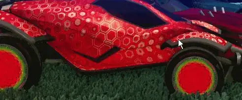

Was watching some Rocket League and notice there was animated decals and wheels.
Image.
I would like to implement something similar to the effects in the image above.
How would I go about writing a Unity Shader to do the wheel effect?
I don't know much about Shaders, but can I edit the standard Unity Shader to do the animation effect?

    Shaders are definitely the go-to solution here, even for something as simple as a scrolling texture. Unity has a built-in _Time variable you can add to your texture coordinates in the (vertex) shader to get a scrolling effect dirt cheap. The hexagon effect would be pretty straightforward too. If you edit your question to highlight just one effect and ask "how would I implement this in a Unity shader," we can probably help you out. Be sure to specify whether the shader needs to respond to lighting/shadowing, as that has impacts on how it would be written. – DMGregory Jan 06 '17 at 00:07
  • Thanks for the info. Have changed my question, is that a little better? I don't really know about the lighting and shadowing, so I left that out for now until I get a better understanding of Shaders. I guess I would want them, but I could just copy parts from the standard shader right? – JacketPotatoeFan Jan 06 '17 at 00:35
    I'll expand on it in an answer a little later tonight (though feel free to beat me to it, if anyone wants to answer now!) - but you'd typically write a Unity shader that uses lighting as a "Surface Shader" while one that doesn't need lighting is often simpler to write as an "Unlit Shader". It looks to me like those wheels are unlit (the slight shadowing at the edge looks like SSAO), so I'd leave lighting out of the picture for starters. Can you clarify: do you want exactly the geometric pattern shown here, or the ability to scroll arbitrary textures outward & rainbow-tint them like that? – DMGregory Jan 06 '17 at 00:39
  • Thanks so much, whatever info you can give to get me started would be great. I really admire people who can write shaders, I''ve looked over a few articles for Unity Shaders, and yeah, very confusing. I think simply scrolling through textures (or texture uvs?) would be good enough, and with the ability to tint. – JacketPotatoeFan Jan 06 '17 at 00:44
