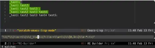

Update 2:
Preview of the "max 4 words" regexp in re-builder:
