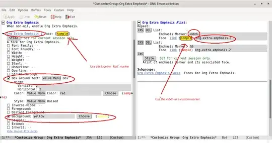

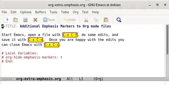

You can use org-extra-emphasis: Extra Emphasis markers for Emacs Org mode.
The solution outlined here works with org-9.5.3.
To get this
Buffer as it is
Buffer when org-extra-emphasis-mode is OFF
Buffer as it is rendered in Emacs with org-extra-emphasis-mode
Buffer as is rendered when org-extra-emphasis-mode is ON
Buffer as it is rendered in Firefox when exporter to HTML
HTML export of org-export-emphasis.org as seen in Firefox
do this
  1. emacs -Q
  2. Download org-extra-emphasis.el to say ~/Downloads/
  3. M-x load-file ~/Downloads/org-extra-emphasis.el
  4. M-x customize-group org-extra-emphasis. Customize org-extra-emphasis-alist variable and org-extra-emphasis-1 face as below.
  5. Open a file org-extra-emphasis.org and fill it with following content. (Note: For some reason, the global value of org-hide-emphasis-markers was not getting inherited in the org buffer. So, I had to force its value using a file local variable.)
#+TITLE: Additional Emphasis Markers to Org mode files
Start Emacs, open a file with <kbd>C-x C-f<kbd>, do some edits, and save it with <kbd>C-x C-s<kbd>. Once you are happy with the edits you can close Emacs with <kbd>C-x C-c<kbd>.
Local Variables:
org-hide-emphasis-markers: t
End:
  1. Steps 4 & 5 are equivalent to
    (custom-set-variables
     '(org-extra-emphasis-alist '(("<kbd>" org-extra-emphasis-1)))
     '(org-hide-emphasis-markers t))
    (custom-set-faces '(org-extra-emphasis-1 ((t (:background "yellow" :box (:line-width (2 . 2) :color "red" :style released-button))))))
  2. Export the above file to HTML with C-c C-e h o. You will get the output shown earlier.
  3. Export the above file to ODT with C-c C-e o O. You won't get the box around the emphasis market, but you will get the background color carried over.
  4. Repeat the above steps with M-x org-extra-emphasis-mode, and investigate the difference.
(Note org-extra-emphasis-mode, contrary to it's name is not a mode at all. Its effect is global)
When using org-extra-emphasis, you cannot use an arbitrary string as a emphasis marker. If some emphasis marker doesn't work with some export backend change the marker to something else.
For example, using "#' as an emphasis marker is a bad idea. There may be no # in your body text, but the HTML exporter may introduce attributes with #--think colors, or hrefs. The filter function cannot distinguish between # you introduced as an extra emphasis and the # that the HTML exporter itself introduced. This means that the export filter will happily mark any stretch of HTML text enclosed within a # as a span, and you will end up with a broken HTML.
Unlike, the solution shared here, which extends the parser, org-extra-emphasis uses an export filter, specifically org-export-filter-plain-text-functions. So, if something goes wrong, you--an intermediate-level user--can easily fix things.
