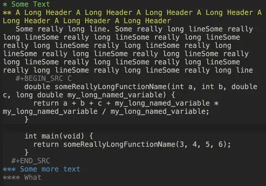

Another solution is to use adaptive-wrap-prefix-mode.
This way you'll see the full header and source but it will wrap nicely indented.
With visual-line-mode:
With visual-line-mode and adaptive-wrap-prefix-mode:
