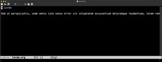

For text-heavy documents that I'm repeatedly editing, I prefer not to continuously fill-paragraph. In these cases I prefer to edit using the full frame width for my monitor.
How can I avoid fill-paragraph in org-mode?
Related
  1. This question has been asked before.
I can indeed set in my .emacs either
(setq 'truncate-lines nil)
or
(setq 'truncate-lines t)
but the latter does not do what I describe above. Ideally I'd isolate this in a hook for just org-mode, but first I need to understand why truncate-lines doesn't do what it's supposed to do.

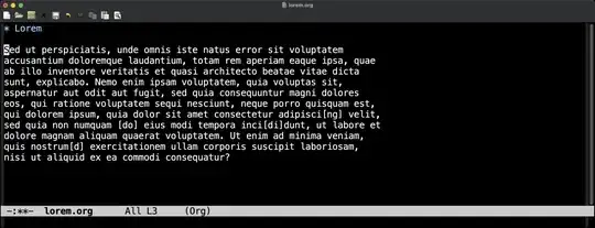

While the answer by NickD does exactly what is asked, I'd recommend enabling visual-line-mode instead:
(add-hook 'org-mode-hook 'visual-line-mode)
This also sets (setq truncate-lines nil), but in addition redefines some editing commands to act on visual lines instead of logical lines (kill-line, move-beginning-of-line, move-end-of-line), turns on word-wrap, ensures line-move-visual is t, changes fringe indicators to visual-line-fringe-indicators (default: none), and makes a few other adjustments which make the user experience nicer when lines are wrapped.
Result of using (add-hook 'org-mode-hook 'visual-line-mode)

    I'm not sure what you mean by "redefines editing commands to act on visual lines instead of logical lines". Both settings make up/down cursor movement act on visual lines. Regardless, this feels like the right solution. I went ahead and added a picture to spare everyone having to try it. I hope you don't mind. – Sam7919 Feb 22 '23 at 14:44
    Thanks. I made a further edit to clarify. – orgtre Feb 22 '23 at 16:43
